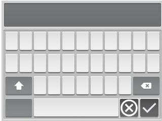

I am using an amended form of the customKeyboard example in one of the TouchGFX demo projects. However, I have shortened the space bar and edited the keyboard to include an OK (tick) button and a cancel button.
keyboard minus the buttons.
These are part of the keyboard, not external buttons like in the demo project. I am taking this approach as my display is 320*240, as is the keyboard.
The code snippet shows what I want to do. However, lines 14 onwards are all executed while the keyboard is visible, so nothing is copied into the text area. I want this function to wait until the keyboard is cleared and the buffer contains the entered text. Waiting for the keyboard to clear and the buffer filled would not be an issue as the RTOS scheduler could switch to other tasks if needed.

Is there a way to conveniently pause the first example until the keyboard entry is complete? The keyboard is an object of class CustomKeyboard, which is made visible via a flex button on the screen and normally hidden by the external buttons. The second method above emulates this external button idea, but hides the keyboard from within the keyboard code. Would a semaphore work here? I am also using the keyboard from other screens.
I hope this gives enough clarity.

i just looked at https://www.youtube.com/watch?v=Tkz9099a7a4 how this keyboard is meant to be used. as far as i understand your ok/cancel button are part of the keyboard keys and not extra buttons. so in the keyboard eventhandler you need to disinguish which button was pressed. if it was ok than you need to check if your requirements(eg. 5 chars entered) are already met.
in the solution in the video there are extra buttons with their own event handler which is only called if exactly this button was pressed so you don't need to differentiate which button you pressed
