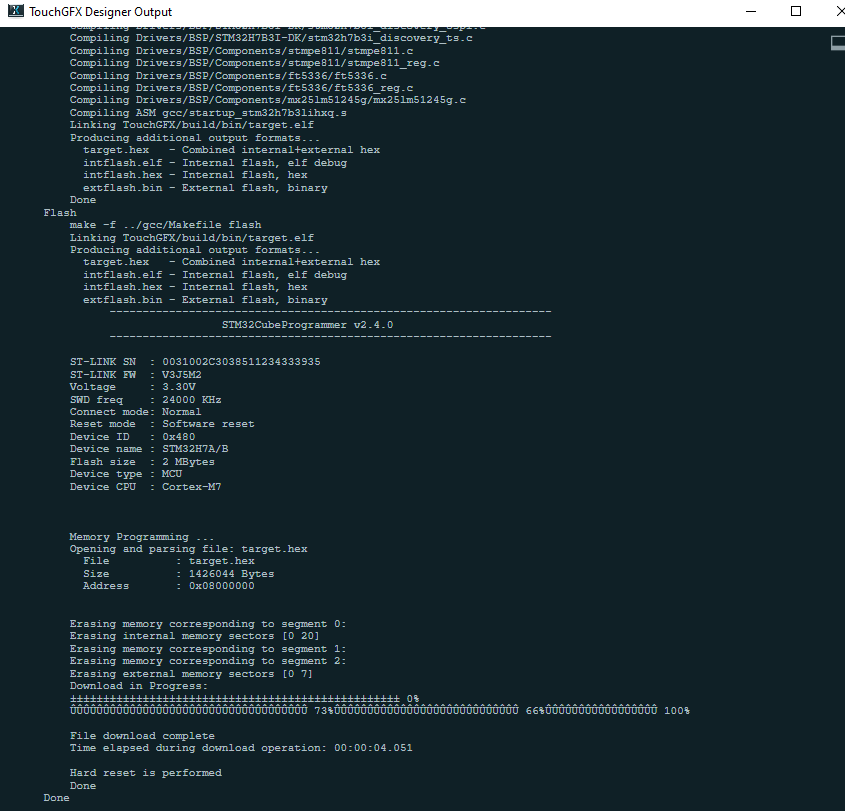

has anyone run an UI-Template with the STM32H7B3I-DK Board?
I get only a black screen....
2020-03-19 4:09 AM
All the time. What happens when you just use a blank template and create a simple application?
/Martin
2020-03-19 4:27 AM
I open GFX Designer, select AT for STM32H7B3I DK and select the blank UI Template.
Create the project and add an Image and a simple Button.
Press "Run Target" and the after building and flashing nothing happens....
2020-03-19 4:32 AM
And flashing is succesful?
2020-03-19 4:34 AM
I think so.
