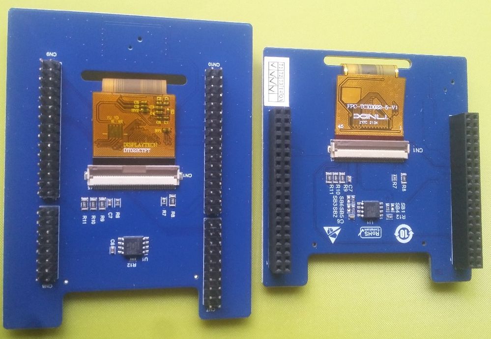

Hello - We are developing a TouchGFX project using a very similar display to that used on the X-NUCLEO-GFX01M2 AZ1 eval (board #MB1642). According to the ST BOM (attached), the LCD is Xinli PN TCXD022IBLON-5. Unfortunately, I can't find a datasheet anywhere online and I need it to figure out particular signals in our wiring. ST must have a copy of that document for internal development of the hardware and software on X-NUCLEO-GFX01M2 AZ1 (MB1642). Please help. Thank you.

The screen is the DT022CTFT, it's marked on the cable assembly

Search terms
FPC-TCXD022-5-V1
XINLI ZXTC 2134
45 PINS
ST7789V

The schematics do in fact have all the pins identified, by name, as the author dropped a symbol for what he/she was wiring against next to the header they were wiring too.
TCXD022IBLON-5 XINLI FPC-TCXD022-5-V1 2.2" LCD INTERFACE ST7789V
1 LED_K4 (BACKLIGHT CATHODE - 24.9R TO GND)
2 IM0 INTERFACE MODE, LOW (SPI - 4 LINE 8-BIT)
3 IM1 HIGH
4 IM2 HIGH
5 IM3 HIGH
6 RESET (*NOT* NRESET, PULLED LOW, 10K TO GND)
7 HSYNC
8 VSYNC
9 DOTCLK
10 ENABLE
11 DB17
12 DB16
13 DB15
14 DB14
15 DB13
16 DB12
17 DB11
18 DB10
19 DB9
20 DB8
21 DB7
22 DB6
23 DB5
24 DB4
25 DB3
26 DB2
27 DB1
28 DB0
29 SDO (MISO)
30 SDI (MOSI)
31 RD
32 RS/SCL (SCK)
33 WR (DCX) DATA/COMMAND
34 CS (NCS) CHIP SELECT
35 FMARK (TE) FLY-BACK / TEARING EFFECT
36 VCC (3.3V)
37 GND (GND)
38 LED_A (BACKLIGHT ANODE + TO 3.3V)
39 LED_K1 (BACKLIGHT CATHODE - 24.9R TO GND)
40 LED_K2
41 LED_K3
42 -NC-
43 TOUCH INTERRUPT
44 TOUCH I2C SCL
45 TOUCH I2C SDA
