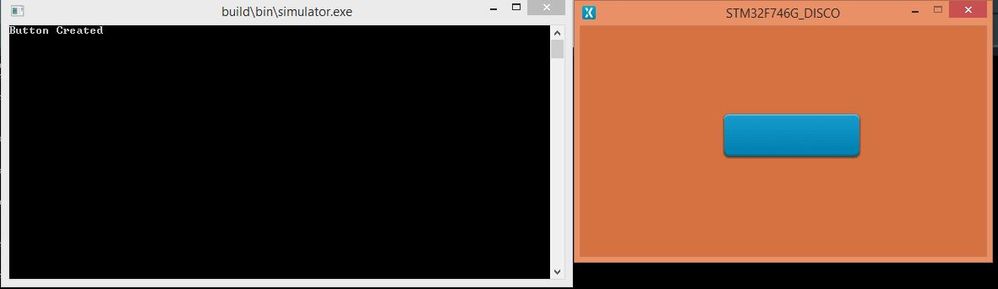

I tried a rough implementation of a button that triggers a callback in the screen view with the current state (PRESSED or RELEASED). For that I based myself on the Designer implementation of a Flex button, creating my own widget based on a combination of ImageButtonStyle.hpp, ClickButtonTrigger.hpp and AbstractContainer.hpp.
Here is the code of the widget as well as the screen view

}You can try with this code first, but make sure the designer knows the bitmaps you're using for the button.
Just to be clear, it is only a rough example and not an official solution
Hope it will help
/Alexandre

2020-12-23 5:30 PM
Hi Alexandre,
I am actually new to the TouchGFX environment. In my application, i need a button having both states (pressed and released.)
I have gone through the above posts and i've implemented the same in my application.
Able to create the button but functionality of pressed and released states are not working.
Below are code snippets:

Could you please help me
