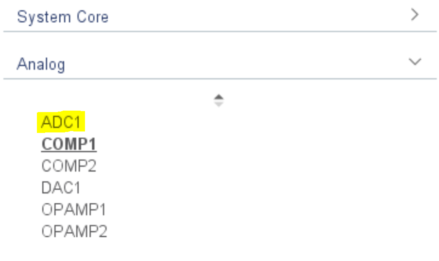

You go to CubeMX (.ioc is not a CubeIDE file, it's a CubeMX file) and configure the ADC. Then you generate code. Do not forget to generate code also from TouchGFX Designer afterwards.
The ADC is among the different elements on the left of the screen in Analog tab.

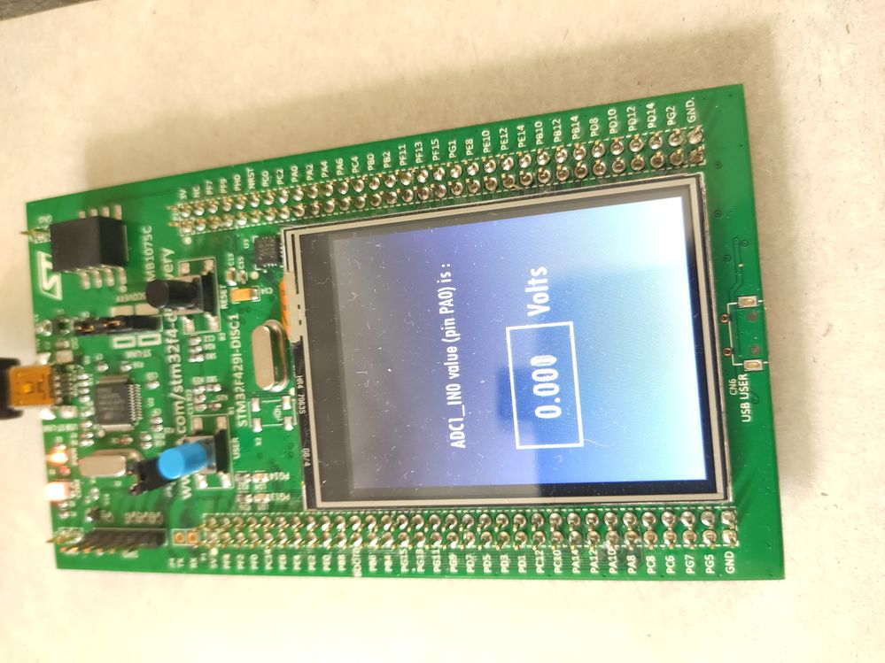

I stopped those unsuccesful experiments and used to go way you provide.
I created touchgfx project, set up my GUI, generated code and close touchgfx designer.
Then i opened cubemx, set up my hardware, generated code. Then again open and re-generate code from touchgfx.
Then via cubeide opened .project file from folder /STM32CubeIDE and wrote my code. Save, build and click "debug". And my voltmeter now works fine. And my further modifications in GUI via touchgfx are well reflected at my board.
It is true, that i had to write some code in folders and files, which are not included in cubeide folder structure (the thing which delivered some misunderstanding and troubles for me as a novice), but that was made well with God's help and now all works fine.
