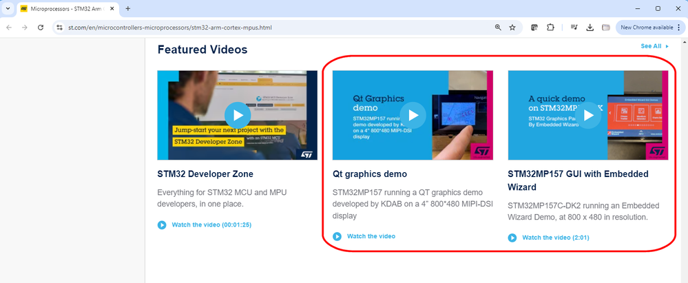

Other options:

2024-09-30 4:54 AM
Right, we know about those and a few more. The question is about Touch GFX. It does not currently support these micros, but has anyone heard of plans that it may in the near future?
