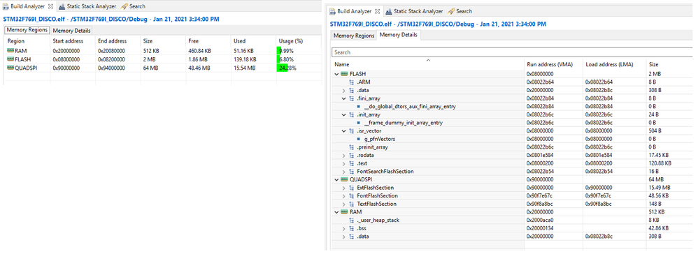

Moreover STM32CubeIDE provides some high level memory usage view, once your project is built through the "Build Analyzer" window, and in the same window but in the "Memory Details" tab you get a deeper view, region per region (as defined in the .ld scatter file) :
