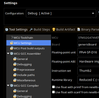

As all other settings...
in IDE, select your project as "active now" , by having the main.c open or click in left window on the project name;
then menu->project->properties
select ... (as in pic) C/C++ build -> settings -> MCUsettings -> X use float with printf
(then float lib is included in build for this project )
