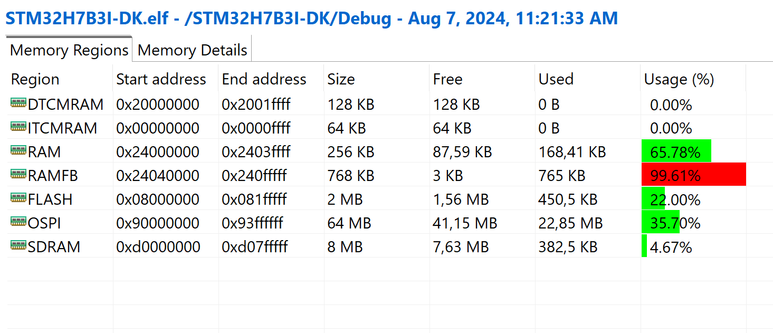

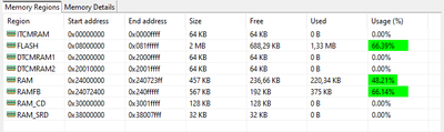

RGB888 + Double Framebuffer
RGB565 + Single Framebuffer

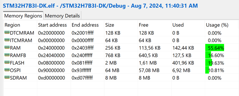

For an extreme case, you can even set RGBA2222 (8bpp) which results in the following memory usage, however, the quality of the graphics might not be acceptable
RGBA2222 + Single Framebuffer

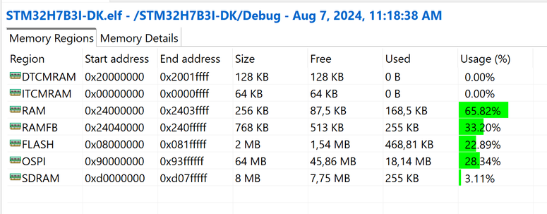

2024-08-08 3:34 AM
Hi @Mohammad MORADI ESFAHANIASL,
don't worry.
Thanks for the suggestion RGBA2222 + Single Framebuffer. I hadn't thought of that. I tried and now I have enough RAM space, but the graphics are not the best :frowning_face:
Allow me another question.

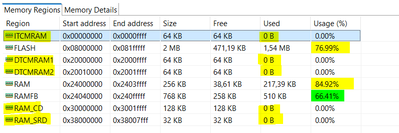

Would it be possible to use the other RAM areas, like those highlighted in the figure?
2024-08-09 5:29 AM
ITCMRAM and DTCRAM cannot be used with LTDC and DMA2D because are non-cacheable section. Also, both these sections and the other ones (RAM_CD and RAM_SRD) are not large enough to accommodate a framebuffer since STM32H7B3I DK uses a 480*272 display and if you set the bit per pixel to 16, you will need:
(480*272*2) / 1024 = 255 KB
which is larger than all of the highlighted memory sections.
Can I ask what you would like to achieve that 16 MB of SDRAM is not enough?
2024-08-09 6:16 AM - edited 2024-08-09 6:45 AM
The RAM occupation that I shared with you with the last image is related to the 480x272 display.
What I want to do is change the display with one with a definition of 800x480.
By configuring ARGB2222 this is the current RAM occupation
but I still have to adapt the graphics part to the new resolution.
If I use RGB565 there is no space in RAM. This is the reason for my first post because I thought, mistakenly, that I could use the partial framebuffer.
Conclusion: for my application RAM are not enough
I think you need an external RAM or switch to a processor from the STM32U5 family with more RAM

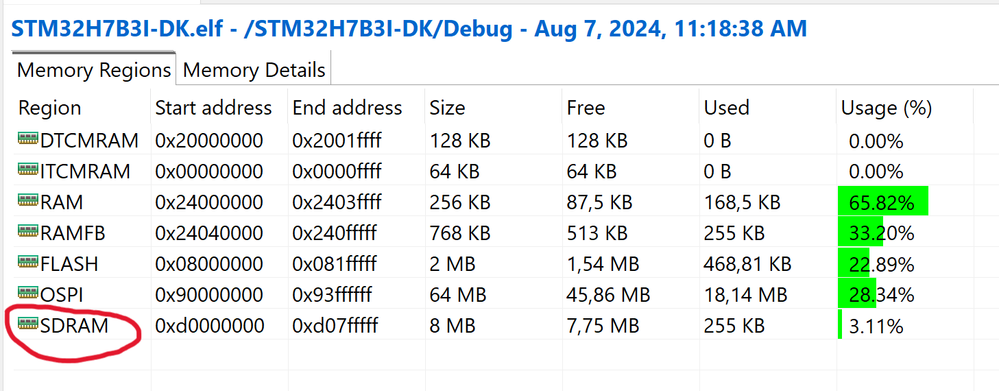

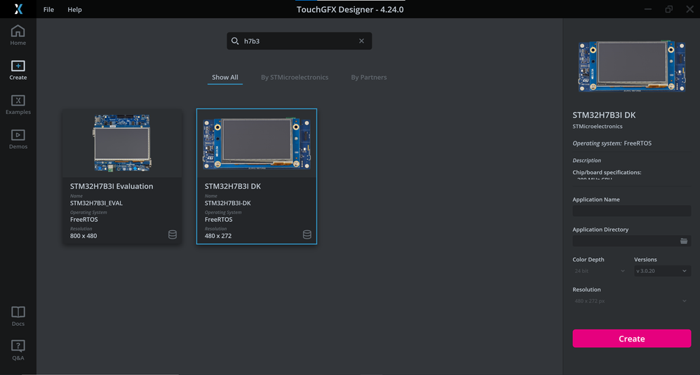

The STM32H7B3I-DK already has external RAM, and it is enabled and configured in the TouchGFX Board Setup that I mentioned previously.
STM32H7B3I-DK Board Setup
As you can see in the memory sections below, SDRAM corresponds to the external RAM section.
SDRAM section
