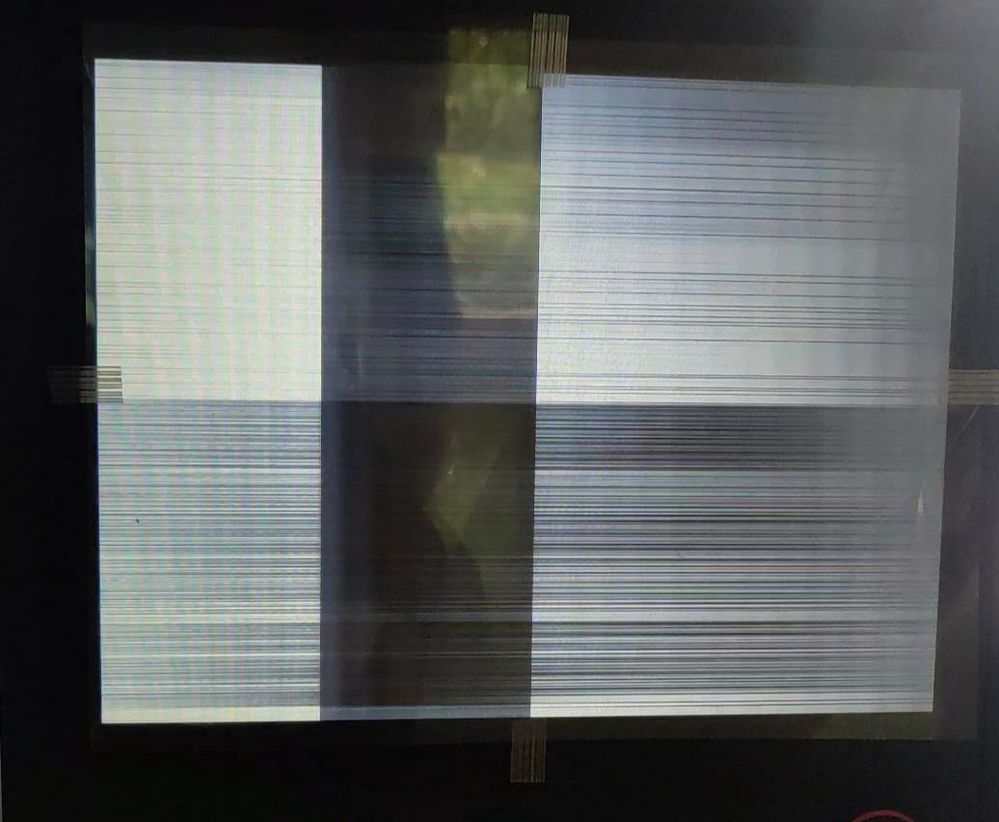

I am working on a custom LCD project using STM32h753 Eval 2. Currently i dont have a tremendous knowledge in LCD. I tried to follow the example codes and some tutorial but not able to make it work. can you suggest any resource or steps to get started?
i am using a custom 1024*768 LCD. This LCD receives signals through LCDT. the config given by the manufacturer is
#define PanelHSyncWidth 43
#define PanelHSyncBackPorch 29

when i try to modify the example code with these data, i was able to get the LCD ON but did not get the expected result.
this is what i get when i change the sync config and clock. what are all the possible reasons where i am messing things up?

Hello @UPa.1 ,
Have a look on this AN4861 Application note LCD-TFT display controller (LTDC) on STM32 MCUs, this may helps you to configure your project.
Best Regards
Imen
2020-10-12 2:05 AM
Thank you. it seems like the problem was with the custom LCD. its solved now.
