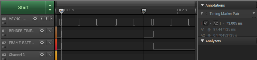

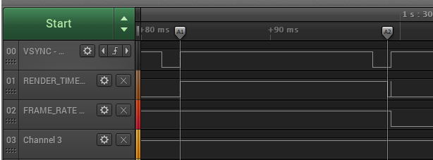

The rendering time for a static frame with 4 buttons without images is about 15ms. With the moving images like above the rendering time is >70ms. The 30ms from the first post where with some optimization (only one wave,...)
I've made a more detailed analysis (see attached excel file). There are 5 "delays" with more than 7ms where the TouchGFX Library is doing something but I don't know what. Do you have any idea what happens there?
I would highly approciate, if you could invest some time for investigation. I can provide you more information if necessary, but I can't share the project within the forum.
Thank you very much
/Marco
Renderingtime static screen:
Renderingtime moving images:
