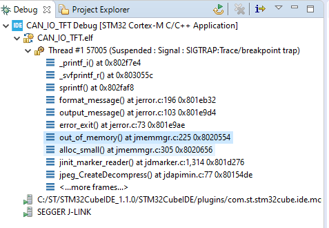

Now i am trying to do the same thing with Jpeg files,
Is there any example using Jpeg , or JPEGLib Source that i can use ??
2020-07-14 1:53 AM
So you're saying there's an error in the code in the article? I'll have to follow up on that.
Check this forum if you can, i uploaded an example using a JPEGFileLoader at some point (uses libjpeg).
/Martin
2020-07-14 2:08 AM
Or i am using an other version of some tool (touchGFX etc).
I think i found the example you are talking about, i ported the libjpeg and the common files but the code gets stuck in
JPEGFileLoader::getJPEGDimensions(f, width, height);
I am using the same cash configuration as in bitmap.
Is there some other cash/memory configuration i have to make ?
2020-07-14 2:16 AM
The example i uploaded was only tested on windows / simulator. Pretty sure our demos from the designer use dynamic images (jpegs) - i don't have time to check myself right now
