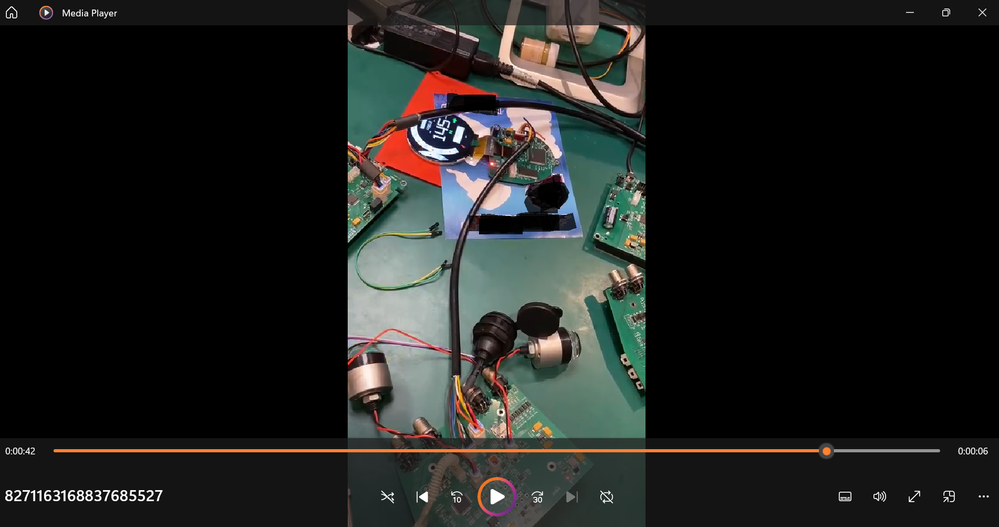

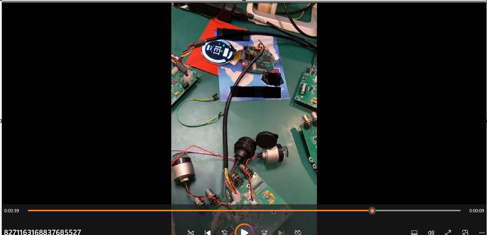

Before
AfterHello everyone.
I am in a tough situation when the LCD shift during display without touching the board as some pictures above:
I am using STM32F469ZIT6 and SDRAM IS42S16400J-6TLI. Here is the configuration:

}Refresh count equals 683 and clock for SDRAM is 90MHz
Can anyone help me? Thank you
2025-10-01 3:46 AM
the display is in the middle of the image for anyone can not see it
