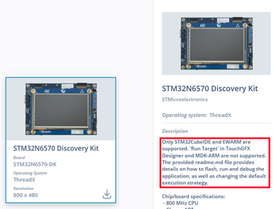

However, currently only STM32CubeIDE and EWARM are supported for compiling applications. This means that you cannot compile and flash applications for the N6 directly within TouchGFX Designer. This limitation is also mentioned in the board setup description, as shown below.
To get started, I recommend reviewing the readme file located in the root folder when creating an N6 project. This file provides detailed information on the limitations and guides for building and flashing applications. Due to the N6's powerful and complex nature, there are several important considerations to be aware of.

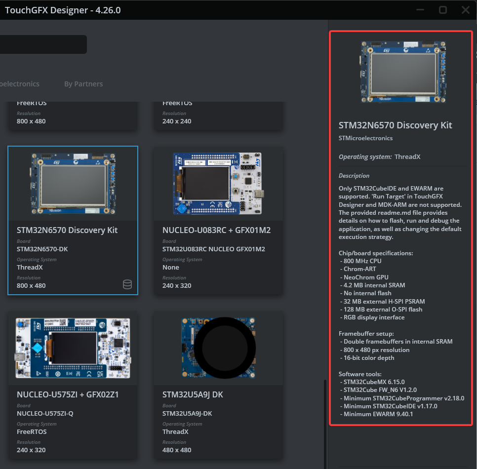

Could you share a screenshot of how it appears in your TouchGFX Designer? I see the description on the right when I select a TBS.
Are you using STM32CubeIDE or EWARM?
To confirm, have you followed this procedure:

Hi Johan, I see it now too.
The problem was that TouchGFX Designer opened with the window maximized to the screen (not preferred).
My screen is 5120 pixels wide, so the description was about a meter to the right; I didn't notice.
For the screenshot below, I resized the window to get them close together.
Sorry to bother you.
I succeeded to flash my code.
