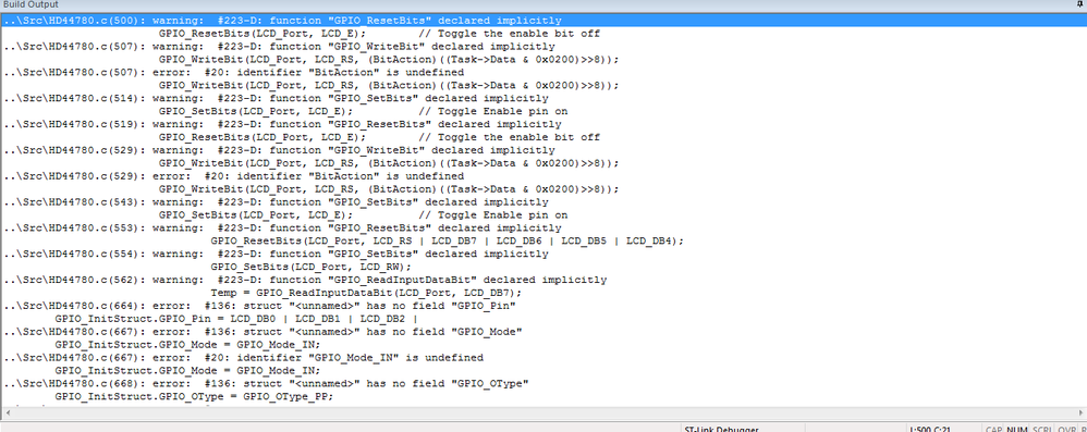

I have used this on STM32F4 board and works pretty well. Thanks for your code . Now I want to use this on STM32F0 board, I ported it but nothing works only dark spots on the upper line of the display. I am able to get the TIM2 interrupt may be something wrong with the RCC configuration. I have cross checked the pin connections an nothing wrong in it. Can you please let me know where I may be going wrong. Thanks and Regards Sajeed2018-07-02 4:38 AM
I am getting the below attached error, when I trying building this. What have I missed out on?
