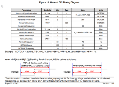

This datasheet : https://www.hpinfotech.ro/ILI9488.pdf tells you some timings to follow :
Is the horizontal synchronization, vertical back porch and DOTCLK Frequency correctly setup?

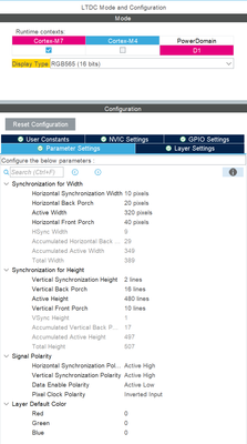

Thanks for responding. Here is the information you asked for:
The values for the first two sections, "Synchronization for Width" and "Synchronization for Height" were provided by Focus LCD. The Signal Polarity I worked out myself.
The DOTCLK frequency is set to 12,307692MHz, which is just above 389 x 507 x 62 = 12.227.826
I believe these all to be within the acceptable bounds. Like I mentioned in my last post - the screen performs wonderfully a few minutes after flashing and has no artifacts during a power cycle. It only happens while flashing.

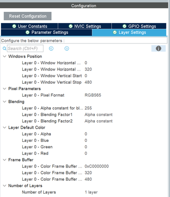

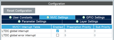

More from LTDC

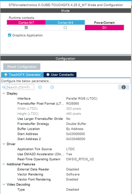

TouchGFX

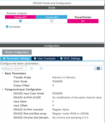

DMA2D
