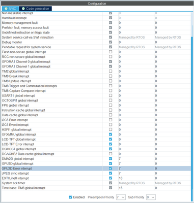

Regarding your inability to show SVG images, I suspect you may have disabled or downprioritized the GPU2D error interrupt. That interrupt is not only used for errors, and is needed to initialize the SVG rendering logic. You should have that enabled, and I would advise giving it the same priority as the normal GPU2D interrupt.
If that does not solve your issue, can you share how and where you hook in to transfer data to your screen?
2025-08-18 5:25 AM - edited 2025-08-18 5:25 AM
Thank you @mathiasmarkussen for your answer.
Both are with the same level of interrupts as you highlighted.
