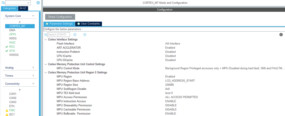

I use CubeMX to construct a project for RGB LCD in a STM32F767 custom board.
MPU is enable, and is set as follow

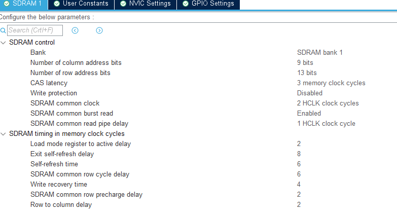

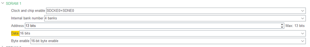

SDRAM is used and FMC is set as :

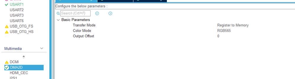

DMA2D is actived and set as :

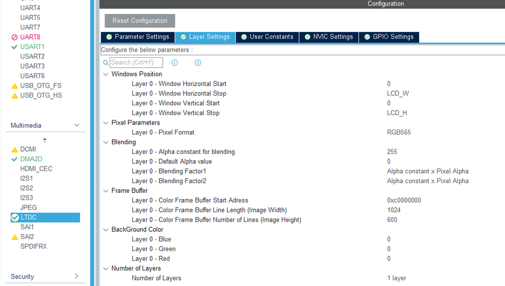

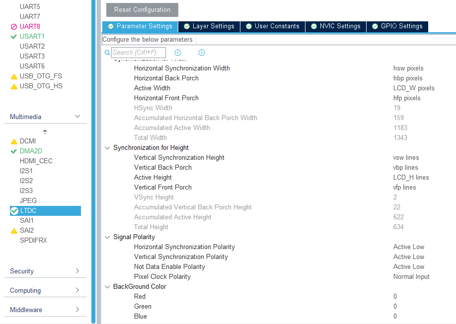

the LTDC is set as :
