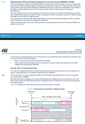

Dear @AQue ,
Thanks for the clarification and sorry for the misunderstanding. It might be a synchronization issue of the framebuffer usage . Can you have a look to this application note :
Hope it helps ,
STOne-32

2024-07-25 7:31 PM
Thank you for this application note as I have not seen it before.
This specific section on the 1 KiB boundary I don't see as an issue in this case. My screen size is 1024x600 in RGB888. Since the width is 1024, it follows that every line is on a 1 KiB boundary (as well as 64 and 128 byte boundaries as well).
I will read the entire application note to see what addition information I can learn.
