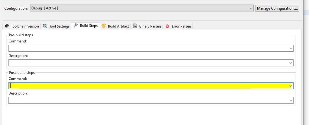

2021-02-07 1:56 AM
Can you help me with this instruction?
I never use it. Have you got an example?
Must I insert the script in this section, right?
2021-02-08 9:27 AM
These aren't things I use day-to-day, and I'm not a CubeIDE user, think of me as the guy on the street giving directions, not the taxi driver.
There is documentation, check what sections you have in your linker script (.LD), check those which have content via (.MAP), or dumping the .ELF file
Here with typical naming from TouchGFX, pick those contributing to your QUADSPI foot print
objcopy --remove-section=ExtFlashSection --remove-section=FontFlashSection --remove-section=TextFlashSection target.elf
2021-02-09 1:26 PM
Sincerely, I appreciate all kind of hints from everyone!
Then I start to experiment and to filter the varoius answer on web.
The result is that objcopy --remove-section command syntax is right . is it also possibile to create a queue:
instead themost important missing code is the first part of the command:
arm-none-eabi-objcopy.exe
writing :
arm-none-eabi-objcopy.exe --remove-section=ExtFlashSection --remove-section=FontFlashSection --remove-section=TextFlashSection "${BuildArtifactFileBaseName}.elf" "${BuildArtifactFileBaseName}.elf"
Everything works.
I checked inside the "*.elf" file the ExtFlashSection, FontFlashSection and TextFlashSection and i discovered that these sections are not even presents.
Thank you so much.
Obviously compiler doesn't generate any errors, but only one warning witch tomorrow I will check:
