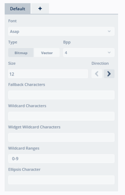

Hello @Heinz_Baumer ,
To be more precise on the previous answer that was given, you have to add the characters you want to be displayed from the wildcard in the "Wildcard range", in the example below, we added all characters between 0 and 9:
