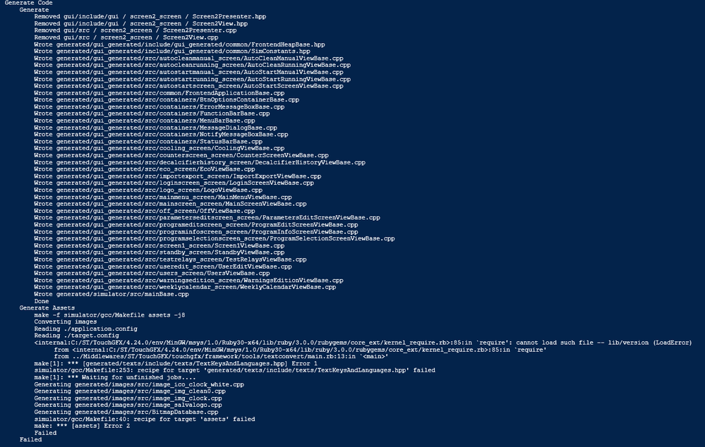

A colleague of mine, afer installing touchgfx 4.24.0 on his machine and cloning our git project gets this error message when trying to generate the files in the designer :
Can someone give me a hint of what's going on? (error message is quite nebulous tbh)
I don't know if it matters but I recently upgrated touchgfx from version 16.0 to 24.0 on my computer (still have both installed) and it works just fine.
I made him installed touchgfx 16.0 just in case but it didn't help.
Thanks in advance.

I just found the problem :
The file 'version.rb' in the folder 'lib' of the textconvert folder (in touchgfx/framewoork/tools) was missing…
(As stated in the error message and pretty obvious for anyone knowing ruby…)

Hey @GaetanGodart ,
Thanks for your answer. Yes, I figured it had to do with the texts generation. My problem is trying to understand what's going on exactly :p
My colleague doesn't seem to have any hidden files in the text folder… Which would be weird anyway as he just cloned the whole git project and I don't have any in mine.
Isn't there any touchgfx employee who works specifically on the generation tools and that could help here?
The error is kind of big because it prevents from even compiling the code…
