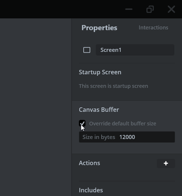

2025-01-07 5:58 AM
Hello @Junde ,
We have fixed the issue and the fix will be live in the incoming 4.25.0 release.
For now, you can prevent the issue by increase the canvas buffer size (check the "Override default buffer size").
Regards,
