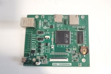

I customized a board with stm32h743iit6 for HMI application, the main hardware features available on the board are RMII ethernet, 32bit SDRAM and LTDC RGB565 interface. Below is the board picture.

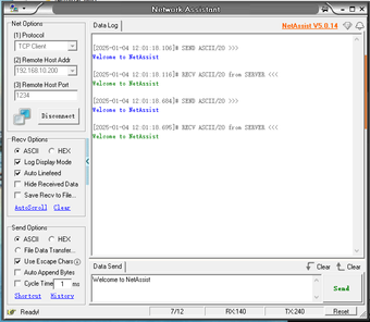

Packet loss ratio is zero even for a very long time test, and tcp echo application works fine.

That is a packed pinout :)
