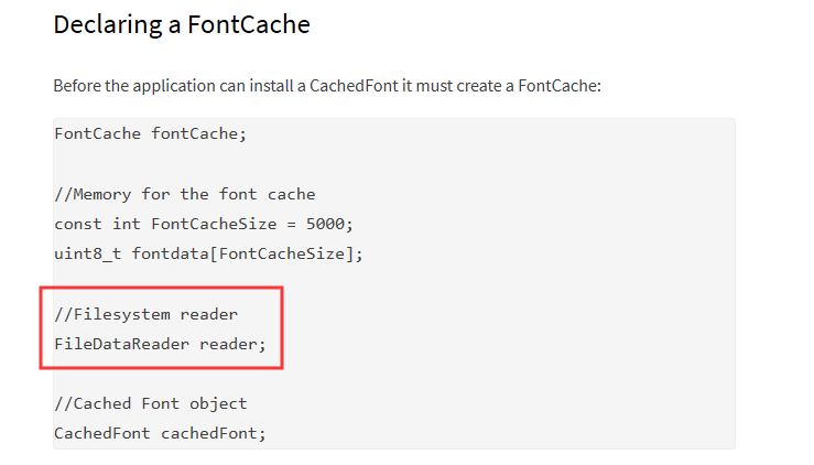

2�?I'm not sure what this filedatareader is. Who can give me an example. The chip is stm32f429bi, and the file system is FatFs.Thank you .

Normally you'd use Binary Fonts because you have a typography that is incredibly large, and you cannot or won't place it in external flash memory, so you place it on an SD-Card. You then have to read this data from the SD-Card (Here's where the FileDataReader comes into play).

1.Can you give me a specific example for the FileDataReader.
