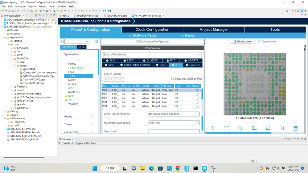

I uses touchGFX associated with Cube IDE with ETH, lwip freertos , it is compiling ok and working. But found ETH gpio pin of ETH in ioc, the max speed is setting to low, so I change it to veryhigh , rebuid the code found a new TouchGFX folder is created automatically, and cause compiing error:
i.e. error: no declaration matches
here is the snapshot in my case

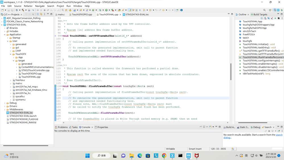

1, initial case, ok and working

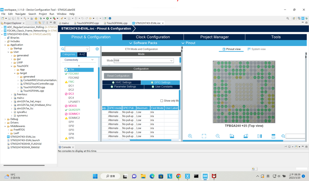

2, foung ETH GPIO speed is low
3, change speed

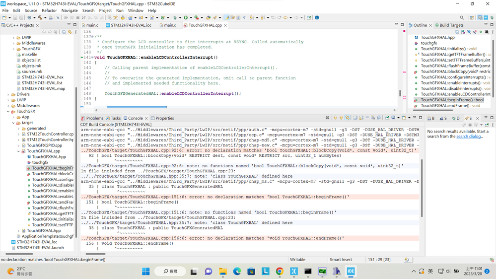

4, rebuild the code, there are new folder (Drivers, LWIP, Middleware and TuchGFX) created automatically at low location , then cause many error as below
