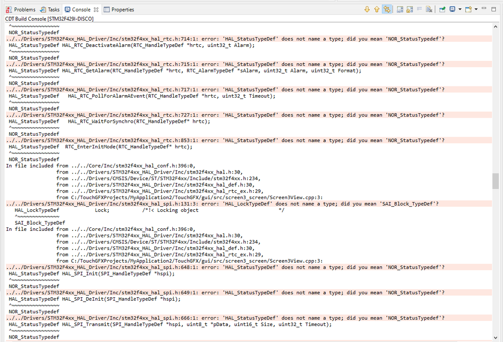

But when I compile, I get more than 300 errors.
Also, I noticed that if I import any module "stm32f4xx_hal..." then I get exactly the same errors.
I don't understand the errors...
Here's my code and it's the third line that poses a problem
and thats the errors i get...

2021-01-15 5:06 AM
I find the solution, I had to include :
#include "stm32f4xx_hal.h"
#include "stm32f4xx_hal_rtc.h"
