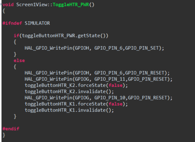

So if I open a .cpp file by double clicking in Project Explorer, the syntax is not highlighted:

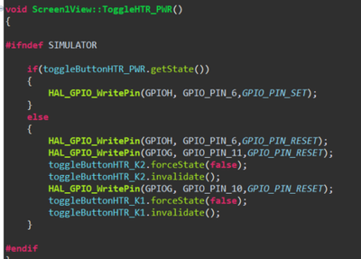

But if I have an error, clicking on the file error opens up the file like this (from Problems Tab):
Both files also open up in the tabs next to each other (as if it doesn't know the file is already open).
Anyone know if there is a fix or how do I open a .cpp file and have it highlighted?
Thanks
2025-07-29 10:25 AM - edited 2025-07-29 10:28 AM
Ok, I figured it out. The files show up in 2 places in Project Explorer. It is appears in both the project folder and the TouchGFX folder. However to get the syntax to work, I had to open it up under the Project folder (Application->User->gui), NOT the TouchGFX folder. Both locations in the tree resolve to the same file, but the one I click determines how it is handled.

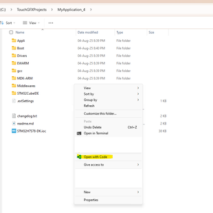

Hello @PaulK101 ,
If you open your project with the IDE that you have generated code for (CubeIDE, Keil or IAR), then all the references should be there and working. However if you use a source code editor, you have to open your project from the project root.
