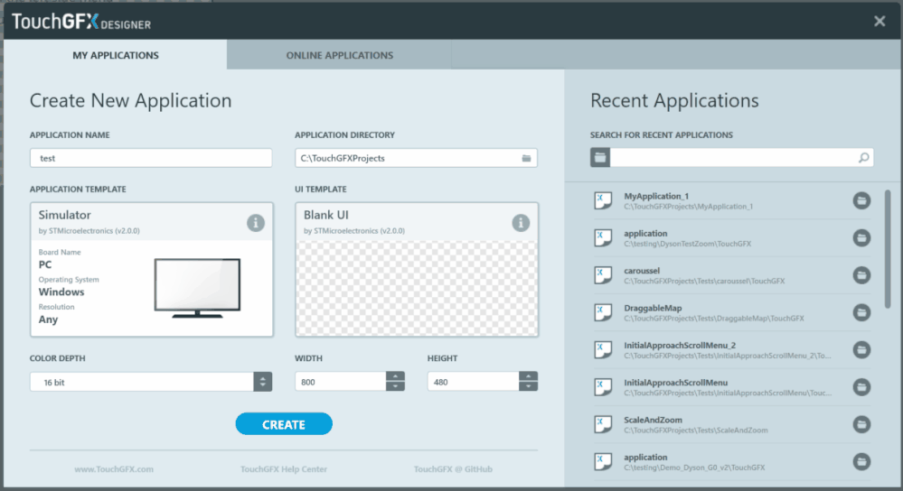

In order to use STM32CubeIDE can you tell me how to import an existing TouchGFX Designer Project?
I am missing a clear documentation for the tools provided by ST.
At the current release, do I even need STM32CubeMX?
I am using an ETEM Board with STM32F746NGH6 Board.
Is the following routine possible: ?
2020-02-24 6:32 AM
when you create a project in TouchGFX Designer, select the right application template directly for that mcu. When you will create your project and generate code, all the configuration will be done automatically for you for this board.
You then do not have to create from scratch a project in STM32CubeIDE, you just need to adapt it to what you have.
