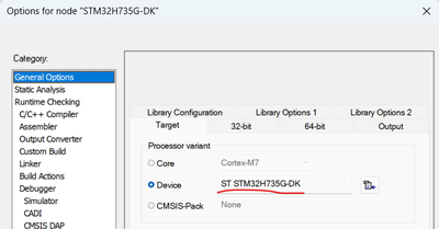

2025-06-11 7:50 PM
I have checked it out. The example project generated from TouchGFX is not correctly configured in IAR.
Select the right chip can solve this problem.
