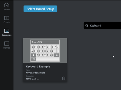

We provide a keyboard example and a custom widget keyboard.
To find the keyboard example, open TouchGFX Designer, go to "Examples" and search for the keyword "Keyboard":
To find the keyboard custom widget, go to the custom widget thread . You can quickly find Juliette's keyboard and if you scroll and look at other pages, some members have made other keyboards.
To modify the keyboard example, you will first need to copy the files in your project then change the mapping to your liking.
