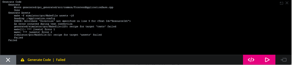

I know they did a lot with typography changes, and I remember reading something in the release notes about a change to how Direction is handled. You might want to try looking in the release notes. You may have to dig a bit, I think there is more detailed information somewhere else that discussed the migration process, but I can't remember where I read it.

Also, there is a 12-minute informative video on Text Management in 4.19 in their blog, found here.
It might be helpful.

i will look into it. atm i think there is not sooo much you can configure wrong but i will try & test
