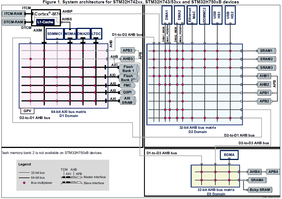

This https://community.st.com/s/article/FAQ-DMA-is-not-working-on-STM32H7-devices pointed me to the conclusion that this is not possible.
The DMA2D can copy data from QSPI to RAM_D2 (this I can confirm from debugging) but the LTDC can not take data from RAM_D2 because there is no connection between them. And therefor using RAM_D2 for frame buffer is not possible on STM32H7. Take a look at the memory architecture below.

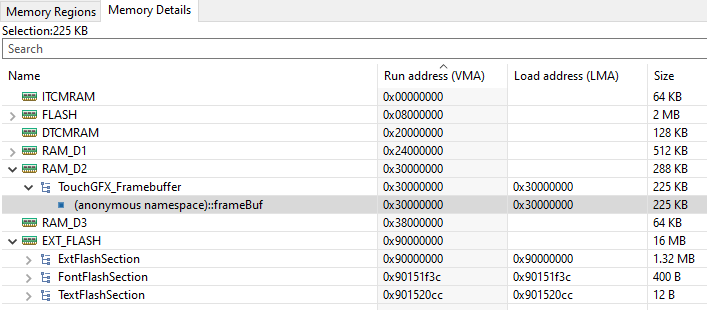

Hi, my framebuffer is (320*240*3) 225KB and the RAM_D2 area is 288KB (using STM32H743ZI) so this should be enough.

2021-01-08 6:59 AM
I can confirm that the RAM_D2 is working, I can read and write to the RAM_D2 area.
The frame buffer is setup to use RAM_D2 address @0x30000000.
But the screen is black, nothing is showing up on the screen...

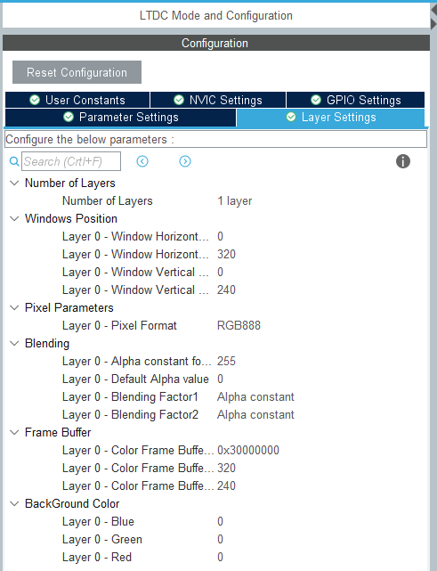

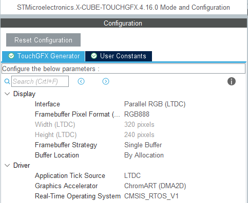

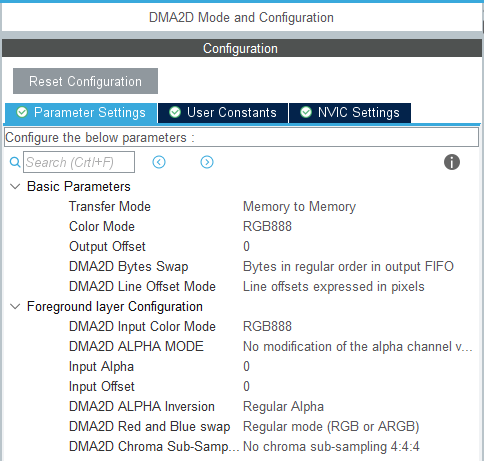

I use the STM32H743ZI on a custom board and I use parallel interface LTDC with ChromART (DMA2D), pixel format RGB888.
When I debug I can se that the LTDC frame buffer CFBADD is set to 0x30000000 (RAM_D2) and also the DMA2D memory address MA is also using the RAM_D2 (0x30000000 to 0x30038400, frame buffer size 225K).
The application is running fine (except for there is no picture on the LCD) and also if I have the application to change the screen picture I can see the RAM_D2 (0x30000000 to 0x30038400) content is changing.
Remember the only thing I have to do is change which RAM (RAM_D1 or RAM_D2) in the linker where the frame buffer (TouchGFX_Framebuffer) shall be, and using RAM_D1 it works fine!
2021-01-13 7:06 AM
Is my conclusion correct?
2021-01-13 12:15 PM
Yes when isnt RAM_D2 accessible over AXI SRAM , then you have right about LTDC. Otherwise MPU is boss.
