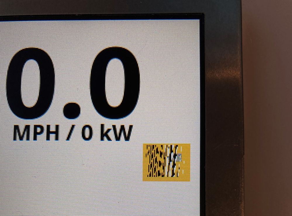

TouchGFX seems to mangle all of my .png images. The image is loaded directly into the flash and mapped in BitmapDatabase.cpp. Nothing special going on. Has anyone encountered this or have any troubleshooting ideas?

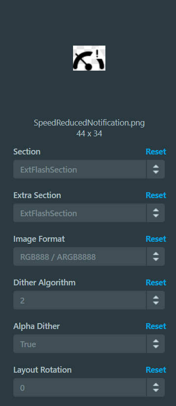

TouchGFX Designer Screen Capture:
Target Picture:
2021-01-12 9:49 AM
Looks like the correct answer was to set the image rotation to 90 deg. Thanks @MM..1. I must have missed why this when setting up my Default Image Configuration: https://support.touchgfx.com/docs/development/ui-development/designer-user-guide/config-view#default-image-configuration
Is there any reason why this setting does not automatically attach to Display Orientation in Config -> Display?

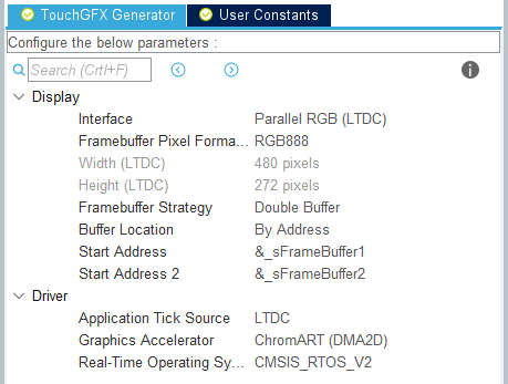

Also please provide more information afterwards like software versions used, what MCU, what board, what display, what framebuffer strategy.

I have not been able to reproduce this issue. The link you shared did not specify as well the TouchGFX Designer version, it is a good thing to hear that rotating back and forth the image solves the issue but it would be nice if we could fix it directly.
@Jon Enz Could you explain what version of TouchGFX you are using ? As Alexandre said, could you share more information on your setup, framebuffer strategy.
Could you share an example of the struggling png images ? Has this happened to images used in the UI examples and demos available from within TouchGFX Designer ?

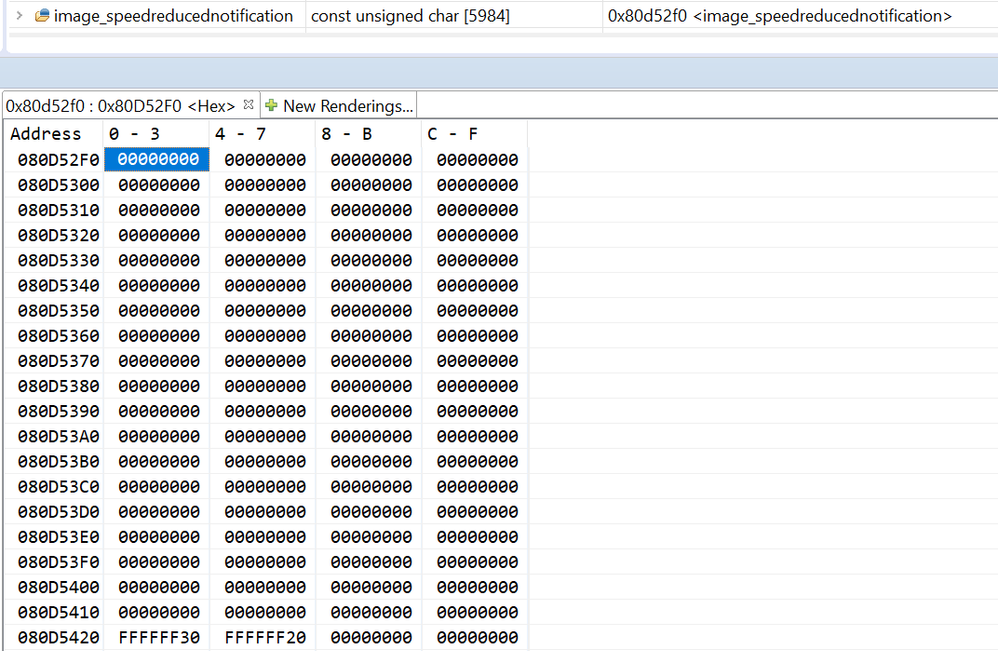

2021-01-12 9:31 AM
My environment includes:
ExtFlashSection :
*(ExtFlashSection ExtFlashSection.*)
*(.gnu.linkonce.r.*)
. = ALIGN(0x4);
} >FLASH// 4.15.0 0x2c2e7c8c D2 AY R0 FARGB8888 U888 N0 SExtFlashSection
// Generated by imageconverter. Please, do not edit!
#include <touchgfx/hal/Config.hpp>
LOCATION_PRAGMA("ExtFlashSection")
KEEP extern const unsigned char image_speedreducednotification[] LOCATION_ATTRIBUTE("ExtFlashSection") = // 44x34 ARGB8888 pixels.
0x00, 0x00, 0x00, 0x00, 0x00, 0x00, 0x00, 0x00, 0x00, 0x00, 0x00, 0x00,
0x00, 0x00, 0x00, 0x00, 0xff, 0xff, 0xff, 0x30, 0xff, 0xff, 0xff, 0x20,
Here is the original .png image:

Hmm try check display orientation in touchgfx config, is here landscape or portrait? When landscape set your png to angle 90 not 0.
Second is your quad buff , touchgfx dont support 180 , better for mcu is use rotation over display controller IC, or use two screens one 0 second 180.
2021-01-12 9:49 AM
