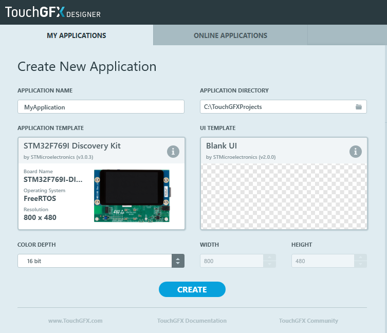

You need to create a new project using the STM32F769-Disco application template and empty GUI template.

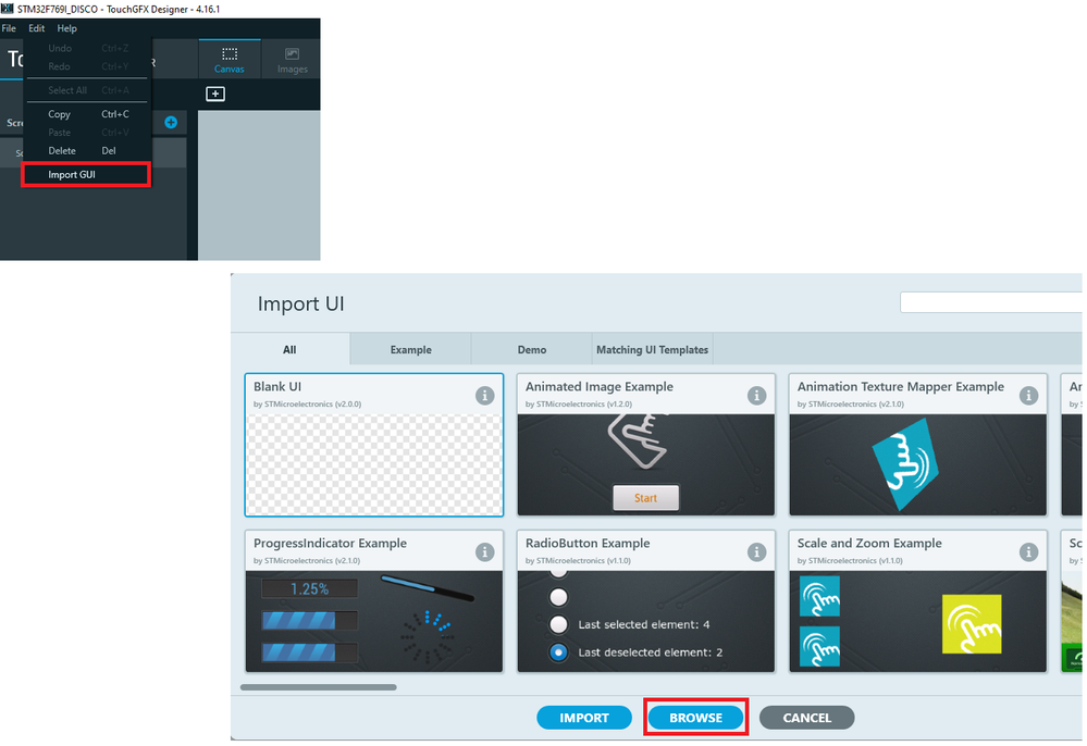

Then use the menu "Edit->Import", then "Browse" and select the .touchgfx file of your simulator project.
