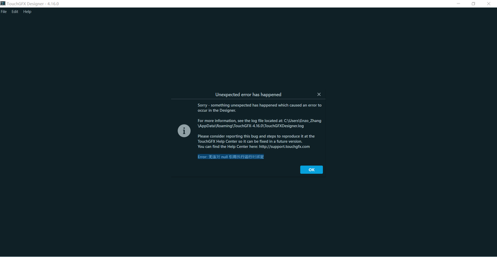

Hello Jzhan.8,
Could you tell us in English the steps you did to arrive to this unexpected error ? Can you reproduce it ?
/Alexandre
2021-06-22 10:55 PM
OK,After using stm32cubemx to generate GUI code, I open the application template.touchgfx.part file in the project directory TouchGFX, and the designer reports an error. Error: I can't perform runtime binding on null reference. How can I solve this problem?Thanks~

2021-06-23 1:19 AM
Your touchgfx.part is empty. It should not happen.
Can you tell me exactly the steps you did to generate it ?
Did you use CubeMX, add the TouchGFX Generator additional software to your project and generate code ?
/Alexandre
