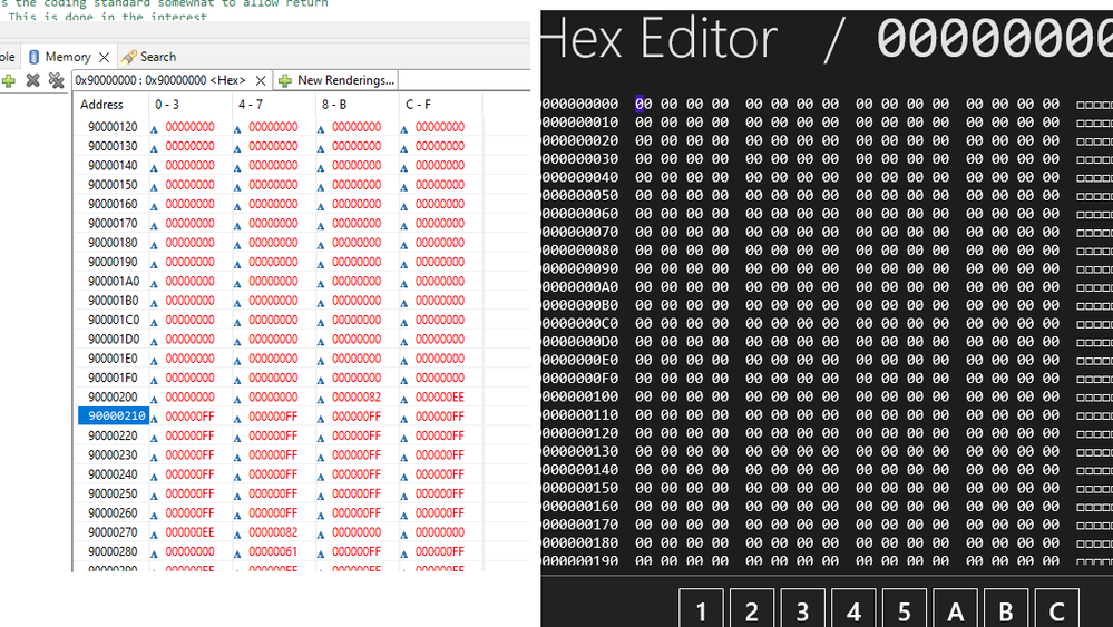

yes, what I see matches my bin file:

I just realized something in the console I am getting this error message some of the time. "Error: Data mismatch found at address 0x90000000 (byte = 0x99 instead of 0x00)" strange thing is when I actually view the memory I am seeing the correct value.
2022-10-31 11:41 AM
well, it seems like I can erase and write to it, but reading sometimes gives me an error. Another strange thing is: I can use st-link to read the memory correctly all the time; however the st-programmer fails to read the memory correctly. (they are using the same custom loader).
