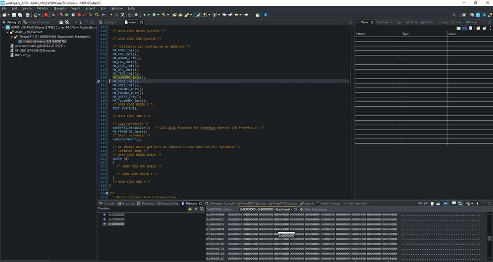

2022-10-31 7:10 AM

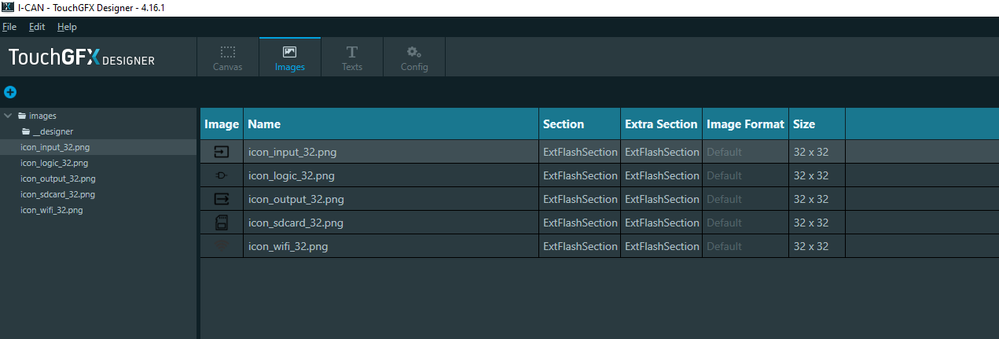

it compiles and runs fine. the only problem I am having is placing the TouchGfx text resources in the external memory. The icons/images are also on the external flash. it works with the icons on the external flash, but when I modified the linker to place the texts on the external flash is when I start having the hard fault issue.
2022-10-31 8:14 AM
If You have hardfault when start then problem is with reading external memory.
When You start debugging after initialization QUADSPI do You see contents memory? (see picture from my project).
