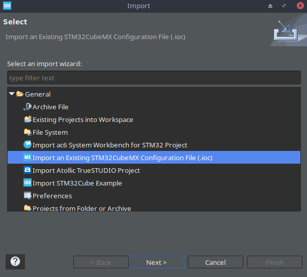

I tried to import the sample code but it imports only the ioc file. Replacing .c & .h files helped but there are still error during compilation.
I am not sure if i need to install some of the packages in Menu: Help->Embedded Software Packages Manager or in the ioc GUI under Middleware & Software Packes.

Hi thanks for your msg.
I tried that and it did not work
I imported the .ioc file which worked but only until the time to compile.
The imported .ioc file was recognized and all param were imported.
When selecting Menu: Project->Generate code it also worked but that would only generate the init code.
I have attached a video with the import process.
It works fine and compiles fine.
https://drive.google.com/file/d/1LklaI5loDt0ETys0LVwLzVHIqG7vK2uR/view?usp=sharing
Then i obviously have to manually copy code from the sample code to the project code.

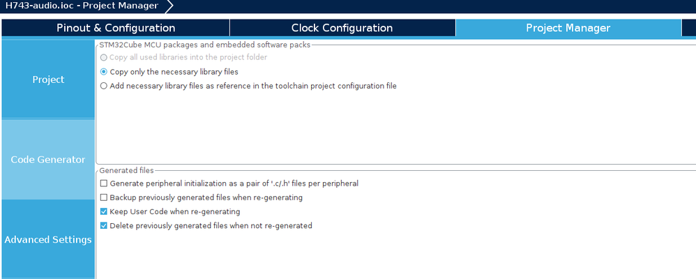

2023-03-11 9:14 AM
AScha.3, i saw the images that you sent.
Not much changed.
I am at the point where i have imported the ioc file with the option that you suggested unchecked.
I am not sure how to continue...
Manos
2023-03-11 9:15 AM
no. read my post - you have to import...from file system . only this way the ide "knows" which files are in this project.
to see whow it should be :
