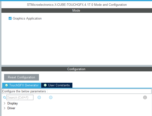

I don't seem to have a 'FlashDataReader' generator
2021-09-07 5:33 AM
I think you need to set the display interface to "Custom" if it is not already the case (not sure why). What MCU are you working with ?

You can actually. I misunderstood how the FlashDataReader option works in STM32CubeMX, it only works when the Framebuffer pixel format is RGB565 (which is initially set when setting the display interface to "Custom". So you can select the display interface "LTDC" and use the FlashDataReader option as long as you are in RGB565.
