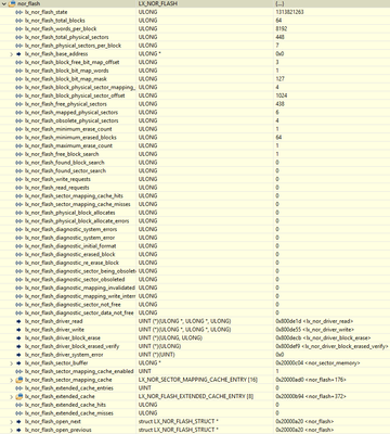

I still haven't managed to resolve this issue.
For your information, here is the information from my storage instance when I do:
lx_nor_flash_open(&nor_flash, "NOR_FLASH_DISK", lx_stm32_nor_custom_driver_initialize);

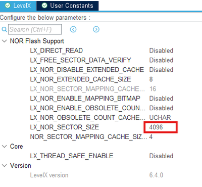

Does LX_NOR_SECTOR_SIZE correspond to the size of a physical sector?
Mine are 4096 bytes (or 1024 words). And will this value define the size of the logical sectors?
I have the impression that the logical sectors need to be 512 bytes.
Can you help me?
thanks

block size does not need to be 512 but you should return a corresponding number in USBD_STORAGE_GetMediaBlocklength(). But it makes just little sense to use large block size for NOR so I would consider setting it to 512. Also, consider returning UX_STATE_NEXT instead of UX_SUCCESS in these two functions. You may call lx_nor_flash_open() in USBD_STORAGE_Activate().
Regards,
Dmitry

I have checked that your flash has 4K sector so you should leave this too. The one more thing I may suppose is that you use LevelX functions but you check for FileX return codes (FX_SUCCESS). That may lead to a situation when your code always ends up in the error handler.
With best regards,
Dmitry

static UINT lx_nor_driver_read(ULONG *flash_address, ULONG *destination, ULONG words)
    UINT ret = LX_SUCCESS;
    /* USER CODE BEGIN NOR_READ */
    uint32 byte_addr = (uint32)(flash_address); // + offset si besoin
    uint32 byte_len = words * sizeof(ULONG);
    if (CMD_READ(byte_addr, (uint8*)destination, byte_len) != FlashOperationSuccess){
    	ret = LX_ERROR;
    /* USER CODE END  NOR_READ */
    return ret;
static UINT lx_nor_driver_write(ULONG *flash_address, ULONG *source, ULONG words)
    /* USER CODE BEGIN NOR_DRIVER_WRITE */
    // Programmer page par page (Max 256 bytes)
    uint32 offset = 0;
    uint32 chunk;
    while (offset < byte_len)
    	if ((byte_len - offset) > NOR_PAGE_SIZE)
    	    chunk = NOR_PAGE_SIZE;
    	else
    	    chunk = byte_len - offset;
        if (CMD_PP(byte_addr + offset, ((uint8*)source) + offset, chunk) != FlashOperationSuccess)
            ret = LX_ERROR;
            break;
        offset += chunk;
    /* USER CODE END  NOR_DRIVER_WRITE */
    return ret;
Hello RemiNao,
first of all I would want to point that one never should use hardcoded values for parameters as it is a low style of programming that leads to many problems. In this case sector size, total number of blocks and so on should be used as defines, preferably that CubeMX has done for you. This way your code will be configurable and portable. Do not tell yourself that "it is for debug only" and then you will correct all this back again. No, low programming practices do not help to debug.
Then, as I have already told your flash has physical sector size of 4K bytes so it is the absolute minimum that you should use for logical sector size. Otherwise LevelX will try to erase on 512 byte blocks which for your flash is simply impossible.
At last, the hard fault means that the caller has reserved less memory than you use. In this particular case I think that the caller (USBX) assumes your sector size less than LevelX assumes. In this case you could surely become a hard fault even with one block, but it is a question of probability.
And one more advice. Switch on stack overflow check while debugging. USBX sometimes needs surprisingly huge stack.
With best regards,
Dmitry
