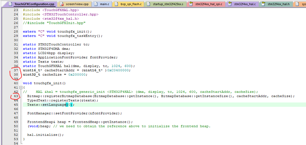

You may not have specified a bitmap cache that is large enough (e.g. size 0 since not configured). Then Bitmap::cacheAll() will never call Bitmap::cache() which calls blockCopy()
You define the bitmap cache in your touchgfx initialization which is outlined in the start of the second article.

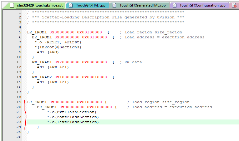

The current situation is to enter hardfault while executing the "void touchgfx::Texts::setLanguage(touchgfx::LanguageId id)" method in the file <texts.cpp>.It happens specifically at the "currentLanguageTypedText = typedTextDatabaseArray[id];" code.The specific code implementation is as follows:
A linked description file for putting assets into SPI-FLASH:
The cache in file <TouchGFXConfiguration.cpp> is configured as follows:
The location where the hardfault occurred is as follows:

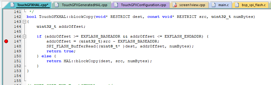

I have been in hardfault without entering the "TouchGFXHAL::blockCopy" method before, because I am new to touchgfx, I don't know where the problem occurs, <Using Non-Memory Mapped Flash for storing images> and <Caching Bitmaps> two official documents I don't understand very well, I hope you can help me out, thanks.

I comment the fonts and text in the linked file, leaving only the image in the external flash. But the blockCopy() method is not called and the LCD displays a flower screen.
