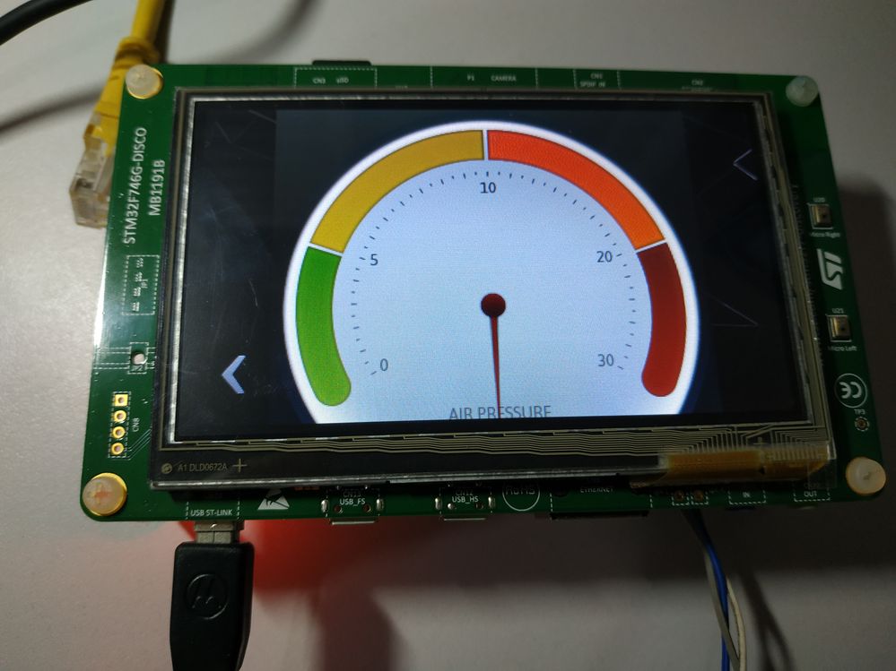

I would like to know how to use Canvas Widgets from scratch. Especially this Widget: https://github.com/touchgfx/touchgfx-open-repository/tree/master/widgets/Gauge
I already read the readme.md from open repository and also this post https://touchgfx.zendesk.com/hc/en-us/articles/205074491-Canvas-Widgets?mobile_site=true
But can't understand how to really integrate inmy project, which files modify and how to manipulate the widget.
Is there any code example about it?

Example code is nowhere to be found, I copied some things I see in the generated files for other screens.
This is how I made it work.
I created a screen in the designer with one box on it to make it blank.
copied the Gauge cpp and hpp files into the project. I put them in with the core files (for now I suppose)
put the bitmap files for the background and center in TouchGFX/assets
generated code in the designer to get the screen built and the bitmaps converted.
in the view .cpp file I added and configured the gauge, added an updating function, and setup the canvasbuffer
GaugeScreen1View::GaugeScreen1View()
touchgfx::CanvasWidgetRenderer::setupBuffer(canvasBuffer, CANVAS_BUFFER_SIZE);
void GaugeScreen1View::setupScreen()
GaugeScreen1ViewBase::setupScreen();
mygauge.setBitmaps(Bitmap(BITMAP_MYGAUGE1_ID), Bitmap(BITMAP_GAUGE_NEEDLE_PIN_ID)); //BITMAP_GAUGE_BACKGROUND_ID
mygauge.setLimits(-100, 200, 180, 450); // input value range, corresponding needle angle (up is 0, clockwise is positive)
mygauge.setXY(245,5);
mygauge.setValue(20);//
add(mygauge);
void GaugeScreen1View::UpdateVal(DisplayData_t * pData)
mygauge.setValue((pData->value)); //
the hpp file needs declarations
class GaugeScreen1View: public GaugeScreen1ViewBase
public:
GaugeScreen1View();
virtual ~GaugeScreen1View() {}
virtual void setupScreen();
virtual void tearDownScreen();
void UpdateVal(DisplayData_t * pData);
protected:
Gauge mygauge;
private:
* Canvas Buffer Size
static const uint16_t CANVAS_BUFFER_SIZE = 7200;
uint8_t canvasBuffer[CANVAS_BUFFER_SIZE];
this should work, I had to strip out some proprietary junk.
I think I changed some things in the Gauge code, I remember changing the needle shape to fit my bitmap. That stuff should be parameterized (which i will do in my stuff).
(this is the type of example code the documentation needs.)

2020-01-21 3:05 PM
Hi Bob, thank you again.
Now I can see the gauge on my display, but I can't change the value.
The gauge not fit on the display too.
Where in the code of the code should I call the "update_val" function?
I'm trying override handleTickEvent to update the gauge value but no success:

2020-01-23 9:30 PM
I used my own bitmap, you may need to resize or replace yours, you may need to change the needle size also
UpdateVal is usually called from the presenter. which is called from the model.
don't add the gauge in the update. you only add it when the screen is "setup" (this is likely your issue)

2020-02-21 1:52 AM
Hi Bob,
can i ask you a quick question on this topic,
im trying to implement the guage and have set it up similar to your example(in hpp and view files), its currently on my third screen but when i press the button to enter the screen the ui becomes unresponsive. i have been reading up on the canvas widget and there is a lot about declaring in target/main.cpp but i dont seem to have this file... but i am thinking its memory allocation that causing this. would you have any idea?
any help or advice is much appreciated ;)
Barry
2020-02-21 6:52 AM
I could not get the canvas buffer stuff to work when I declared it in the main.cpp file, so I put it in the screen files, you can see where its in the view.cpp and .hpp files above.
does the screen work without the gauge on it?
what changes have you made to the gauge class, perhaps remove alterations until you get back to something that works.
you can post some of the code also, so we (community members, and ST people) can take a look
Bob
2020-02-24 8:31 AM
Hey Bob,
thanks for getting back to me, i have it working now as experiment, i am updating it from main through RTOS queue and it seems to be working fine.
my problem was the alterations i was making, i had so many lines commented out and so on it was better to just started a new project. then ST link wouldst flash the board :-(... so i eventually i re did it through the designer and fingers crossed it looks to be working fine..
next job now it to amalgamate different parts of project.
one more question if you dont mind can you re size the gauge in code or does it need to be done externally
Barry
2020-02-24 5:58 PM
I have not done it, but the gauge should be able to be resized. will just take some work.
I don't believe you will find any documentation or examples though. So you will just have to experiment.
Post back your results
