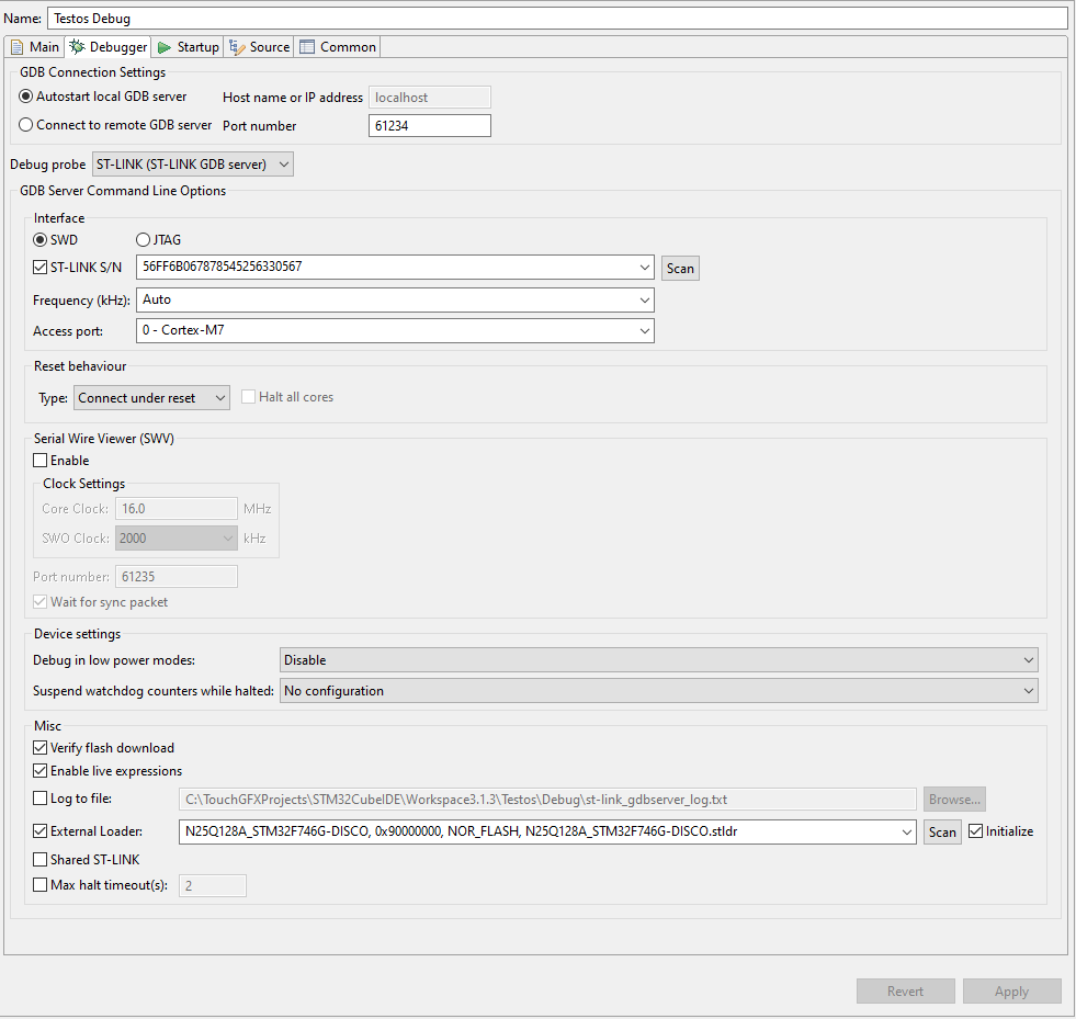

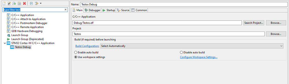

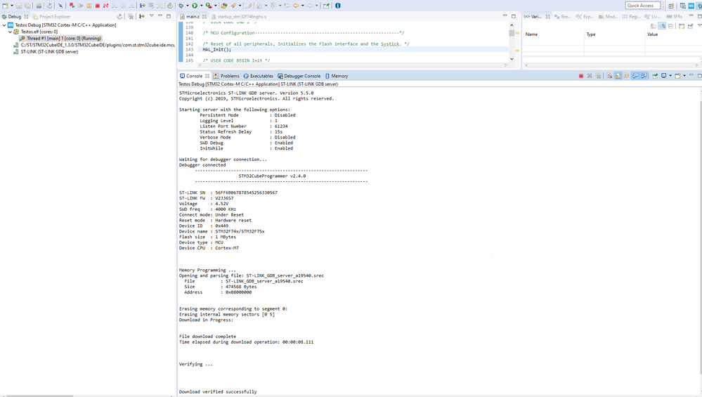

I was trying to find a step by step tutorial on how to import a Project using TouchGFX Designer with a given template (e.g. STM32F746G Discovery Kit), using some matching UI Template, generate code and afterwards import the project into STM32CubeIDE.
Finally build the project inside STM32CubeIDE and debug / flash it via ST Link V2 onto my board.
Unfortunately I end up with a Black screen + some Background light.
No Errors during the build, connect to ST Link V2 Debugger and flash.

Unfortunately I am using a board that neither is in the "board selection", meaning I have to setup the board myself but missing infos & knowledge, nor does the most up to date template of the board within TouchGFX Designer create a ".ioc" file or anything similar I could import into STM32CubeIDE allowing me to build & debug it.
2020-03-02 4:13 AM
In another Thread i found something, what could be helpful for you too... It´s also based on F746 Disco... For me, both ways work fine: From the Videos or from the "manual" of that Link.
Of course it delivers a project, set up for the F746 Discovery but in CubeMX you have the possibility to change the hardware according to your board. CubeMX and Touch GFX Designer are both working fine (integrated) in CubeIDE this way :)
