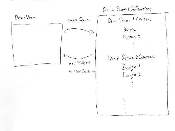

2020-07-12 4:38 PM
deleted
2020-07-12 4:39 PM
Hello Alexandre,
"I feel like (correct me if I'm wrong) that you want a kind of template. Like the backgrounds, icons, etc... must be shared."
Yes. That's nearly what I want to do, and I think I can solve the problem by the way what you suggest.
Our project is the first one who use TouchGFX for product and I'm creating a demo project for other members who use TouchGFX after us.
However, the demo project is taken over from a predecessor, and the project was designed like this.
When the switch screen was called, all widgets are removed from the Root Container by calling deleteScreen() function and the application calls createScreen() function.
In the createScreen() function, the widgets are initialized and added to the Root Container.
void DemoScreenView::createPage(demo::UIFormIndex const index)
std::queue<Drawable*> drawableQue;
demo::createDemoPages[index](drawableQue, presenter);
while (!drawableQue.empty()) {
add(*drawableQue.front());
drawableQue.pop();
getRootContainer().invalidate();
void DemoScreenView::deletePage()
Application::getInstance()->clearAllTimerWidgets();
Drawable* drawable = nullptr;
while (drawable = getRootContainer().getFirstChild()) {
remove(*drawable);
delete drawable;
}The parameters of the widgets are defined in the other file and the code has those widgets like this.
// DemoPageDifinitions.hpp
struct DemoPage1Content {
PixelDataWidget* bgPixel;
Button* demoButton;
void createDemoPage1(std::queue<Drawable*> &drawableQue, DemoPagePresenter *const listener);
void createDemoPage2(std::queue<Drawable*> &drawableQue, DemoPagePresenter *const listener);
static void (*createDemoPages[Index::NumPages])(std::queue<Drawable*> &drawableQue, DemoPagePresenter *const listener) =
createDemoPage1,
createDemoPage2,
// DemoPageDefinitions.cpp
void createDemoPage1(queue<Drawable*> &drawableQue, DemoPagePresenter *const presenter)
// widget initialize here
demoPage1.bgPixel = new PixelDataWidget();
drawableQue.push(&demoPage1.bgPixel);
drawableQue.push(&demoPage1.demoButton);
};I don't know why he implemented so. and I do think I should add screens.
But I don't want to spend much time to modify a demo project, so I asked if there's a way to solve.
That is the situation and what I'm going to do.

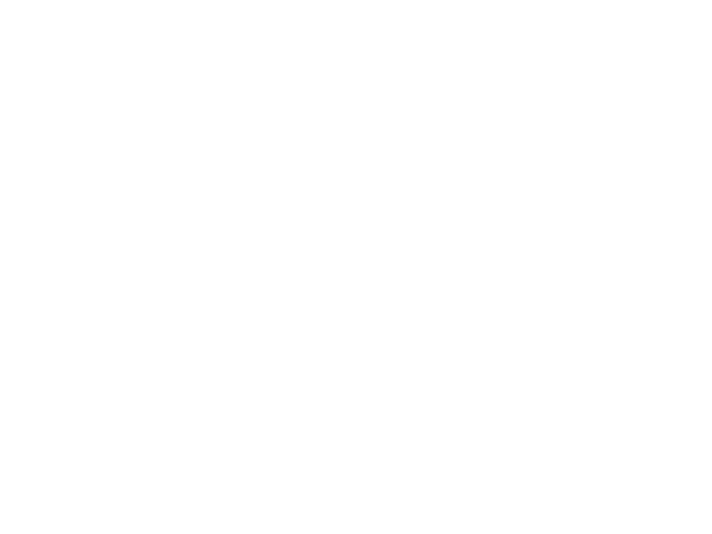

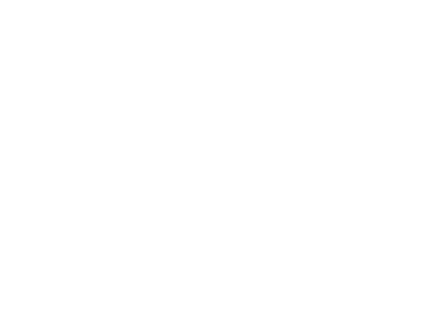

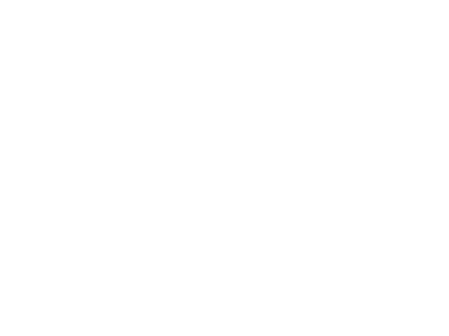

2020-07-13 3:19 PM
Hello Alexandre,
"I'm sorry but I still don't understand exactly what is the application about."
Well, this application is just a demo application to show widgets TouchGFX have, so that the other who is interested in using TouchGFX can know what it can do.
It has some screens and you can switch screens by pressing button on the screen or hardware switch.
Here's some examples of the screens.
Screen1 Button Demo (and some test widgets)
Screen2 Animated Image Demo
Screen3 List Layout and Scrollable Container Demo
