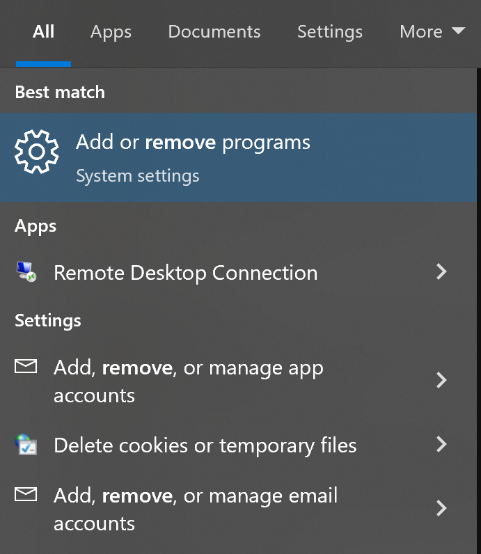

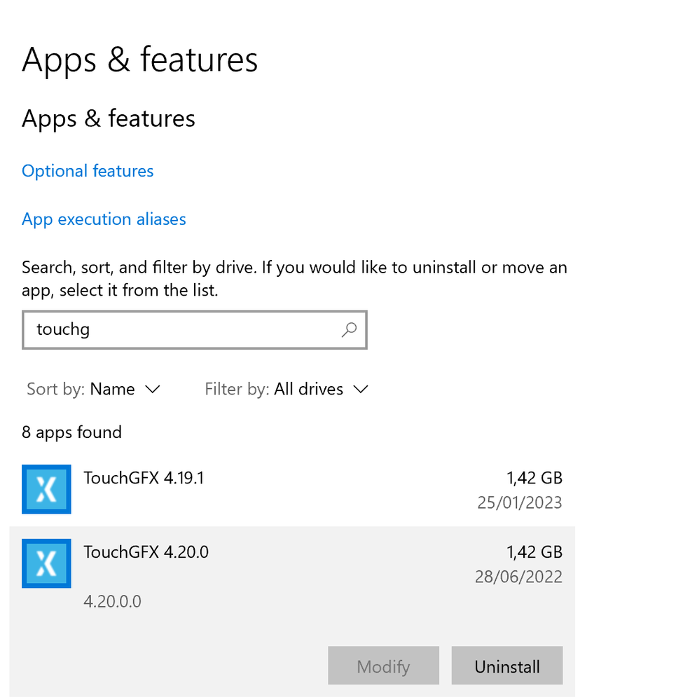

Hello @CSche.4,
That can be easily done by opening the "Apps & features" settings pane of Windows.
You can simply write "Add or remove programs" in the Windows search bar.
Then search "TouchGFX" in the programs list, select the version you wanna delete, click "Uninstall", and follow the instructions on the screen.

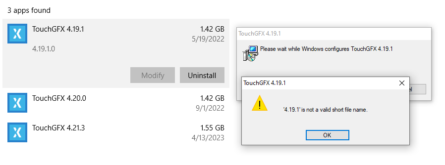

2023-05-22 6:45 AM - edited 2023-11-20 5:01 AM
Yes, all of this I have tried. it still gets the same error when trying to remove either the 4.19 or 4.20.

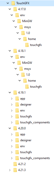

2023-05-22 10:26 AM - edited 2023-11-20 5:01 AM
current installation is:
F:\TouchGFX\4.21.3\env\MinGW\msys\1.0\msys.bat
it seems a residue of directories are left behind with each uninstall.
But 4.19, 4.20 will not disappear at all .
