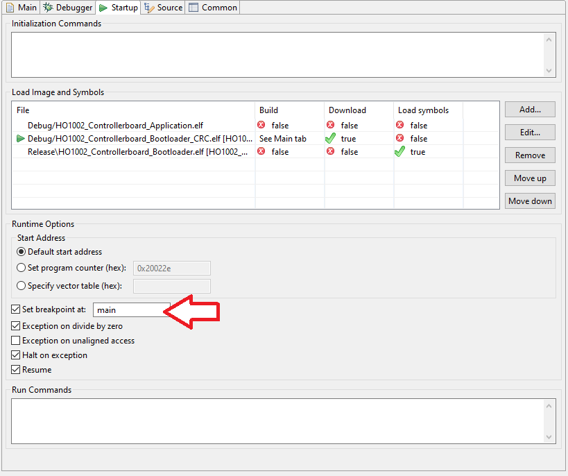

Look in the next tab "startup"

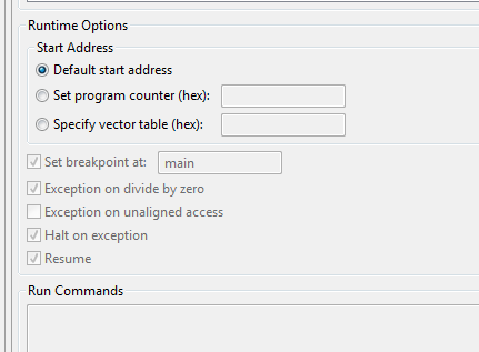

Well spotted, but mine is grayed-out

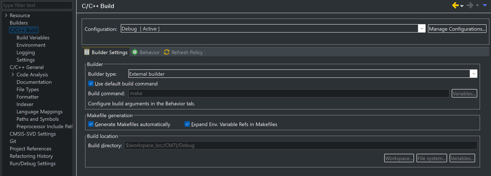

Do you see `Builder type` set to `Exernal builder`? I think you have this option selected the same way I have. Why do I have it selected? Because the internal builder is totally broken and not usable, since it just crashes 99% times I try to build my project. It's a steaming pile of junk, do not use, ever again. I have PTSD from waiting for 15 minutes to build my project and then having to kill the CubeIDE, restart it, wait another 5 minutes for it to open again, wait another 15 minutes to "4%" to find out it's not responsive and then start over. So - this bug is worked around by selecting `External builder` - it works. Just like this. It's not fast, it's not "better", but does one "simple" thing: builds the project. However...
I have startup options grayed out exactly as in your picture. But there's more! I have breakpoint at `main` DISABLED ;) Why do I have it? Because you can set this option when the `Builder type` is set to `Internal builder`. So - set it up, apply, change the startup option, then DON'T FORGET TO SWITCH THE BUILDER TO `EXTERNAL` if you want your project to build at all and save countless hours lost on its crashes.
