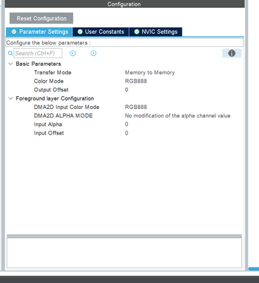

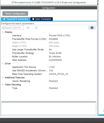

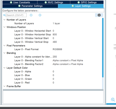

I am currently trying to use touchGFX to design my GUI in a custom board. Before trying to use touchGFX, I set up the LTDC and FMC to use an external SDRAM to hold the buffer and it works fine (I can draw on the screen). However, I've been struggling to setup the touchGFX and being able to only get some random pixels. I noticed from the templates that an external flash is being used to hold initial assets generated at touchGFX, but my board does not have an external flash right now.
Is it possible to run touchGFX from internal flash, and use only external sdram for the framebuffer?
I'll share the configurations I have so far:
And here is my ld file:
