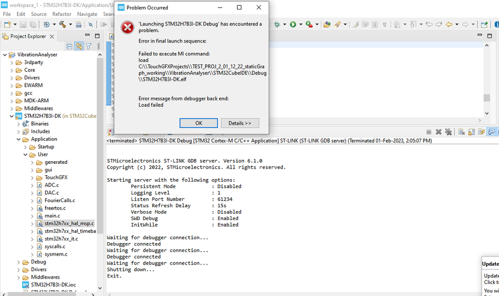

I am working on STM32H7B3I-DK with Touchgfx interface (using FreeRTOS ).The project was working well ,where the loading and running was successful but we started facing "Failed to Execute MI command" issue while loading. At end we created new project from scratch and it worked well. But after working fine for 2 day, with given no change or modification , the next very day while loading at first attempt ,we again started to face the same error.
The error itself is not consistent
Kindly note that we are using on board ADC and the same project (with same configurations) but has no Touchgfx or any FreeRTOS is loading and running fine.
Kindly find the uploaded error message image and hardware configuration file (.ioc) for reference

Hello,@Romain DIELEMAN Thank you for your reply. I have faced "Failed in erasing flash" issue sometimes, as you said it occurred when we run multiple times debugging on target and hence unplug and plug did the magic . But , this issue is different I feel , as you can see the below image , once the debug is selected, we are getting the error message immediately, and as you can see the console , only few lines have been printed and terminated . I think it has not yet reached erasing flash step .Kindly correct me if I am wrong and provide further solution .
