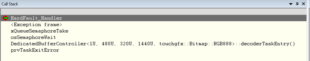

I am tryin to use video decoding that came with TouchGFX 4.18 version. I have a hardware with STM32H743. I can use video decoding with "Direct to Frame Buffer" stretagy buy it's creat some corruption in frame. Image just sliding little bit on screen sometimes. I think, it probably decoding speed cannot reach to flashing speed sometimes.
So I decide to change decoding strategy. If I could use double buffering it will be solve speed problem. Video maybe glitch sometime but whole screen wont. But when I slect stretagy to other than "Direct to Frame Buffer" come go hardfoult coused by semaphore.

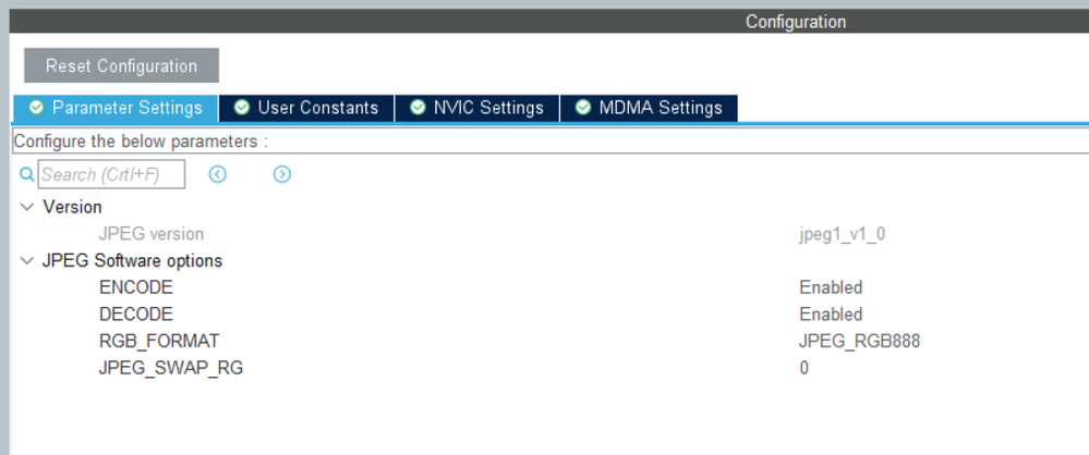

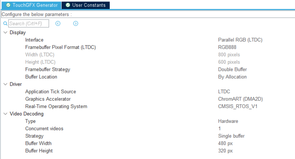

Have you followed this documentation (+ this one) when you configured your board on STM32CubeMX ? Can you share your configuration with us ? (Multimedia ->JPEG / Middleware->LIBJPEG / Software Packs ->TouchGFX Generator->Video Decoding)
/Osman
2022-03-04 10:41 AM
Hi Osman,
I was not followed that documents before. Thank you share but it's not solve problem either. You can find configurations of my project below. I also add hard fault call stack.
Thanks in advance
/Yunus

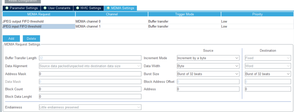

Did you add the code to configure the MDMA like mentioned ?
In Core\Src\stm32h7xx_hal_msp.c :
void HAL_JPEG_MspInit(JPEG_HandleTypeDef* hjpeg)
if(hjpeg->Instance==JPEG)
/* USER CODE BEGIN JPEG_MspInit 0 */
hmdma_jpeg_infifo_th.Init.Request = MDMA_REQUEST_JPEG_INFIFO_TH;
hmdma_jpeg_outfifo_th.Init.Request = MDMA_REQUEST_JPEG_OUTFIFO_TH;
/* USER CODE END JPEG_MspInit 0 */

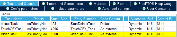

...Also, make sure you have a good configuration of FreeRTOS as described here.
/Osman
2022-03-07 4:59 AM
Hi Osman,
Yes, I did like mentioned in documents.
